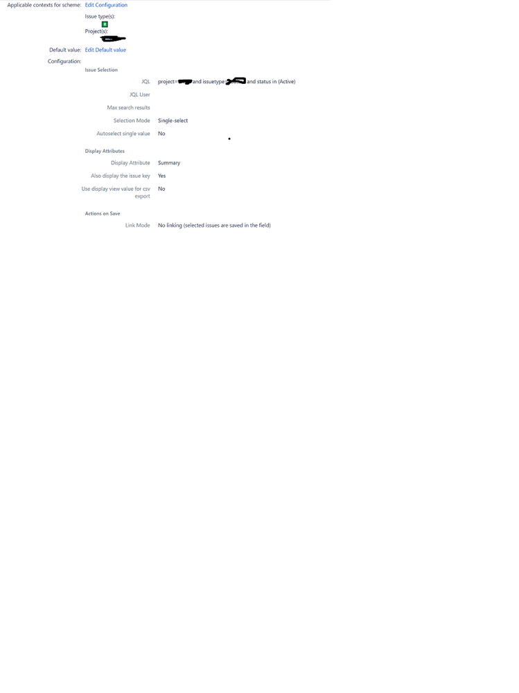

You can use issue picker custom field or query linker custom field to configure this.
It is a plugin where in you can have your JQL to list only initiatives and issue type can be set to whatever you wish. Below is the context of how issue picker custom field can be used.
Just to complement @Aditya Sastry answer, this is the link to Script Runner's documentation about the Issue Picker field.
