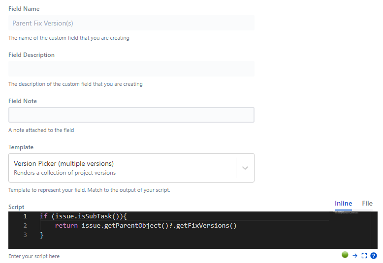

You are absolutely right, you should use a script field in that case. This is how I did it :
with the code :
if (issue.isSubTask()){
return issue.getParentObject()?.getFixVersions()
This is how it appears on the view screen :
