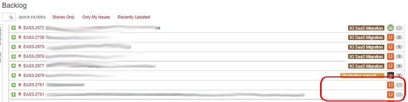

When viewing the backlog of one project (A), I can view stories from a different project (B). However, where stories in the current project (A) display the Epic name, those from the other project (B) do not display the Epic name when the Epic is in another project (B). Is there a way to make the Epic name display?

Thanks for the reply! I've attached an example. I'm looking at the backlog for the EAS3 project. All of the stories are EAS3. The first 6 belong to Epics that are also in the EAS3 project. The bottom 2 belong to Epics in another project, say EAS2 and you don't see the Epic name like the others.

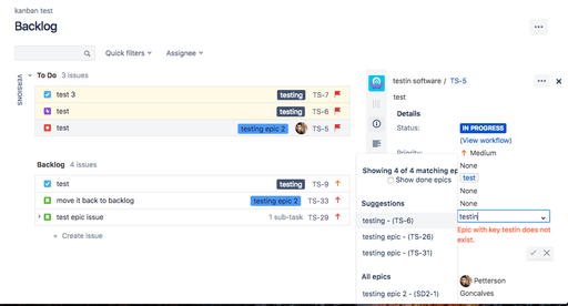

Testing the behavior you described, the Epics from different projects linked to my issues are properly displaying on my board. The Epic Testing Epic 2 is properly displayed on my board although it is from a different project (SD2), as you can see below:
That being said, I started to dig a little bit further and, finally, I was able to reproduce the same scenario as you when I removed my Browse Projects permission from the SD2 (The Epic's project).
