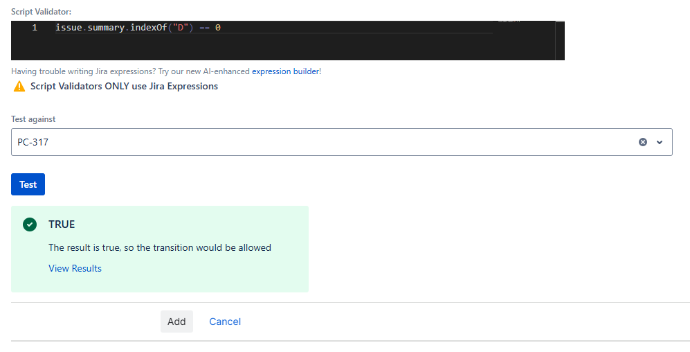

I tested indexOf() more carefully, testing if it can find a single character and found that it does NOT work at all:  issue.customfield_10043.indexOf("Q")===3
Edited my custom field in my test issue and placed Q in position 3.  The condition evaluated to false.  Also tested adjacent positions - just in case.
So I changed my condition to check if slice() works and found that it does for the following condition:
(issue.customfield_10043.length > 0) && (issue.customfield_10043.slice(0, 28) != "*** Enter test plan here ***")
This tests if my custom field has anything in it and if the first 28 characters do not match my default text string.
