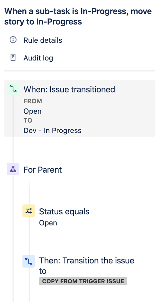

i'm not quite following as to what transpired however, lets investigate the automation in place.
So if I understand you have the above automation enabled for a specific project correct? But the automation is failing, correct? What do the logs tell you? Can you share an image of the logs? I suspect they will convey where the rule is exiting.
You might consider adding a "Log action" to your automation to record info about the execution to help debug. However, this appears to be a pretty straightforward rule. I do wonder why you don't have a condition after trigger to check if issuetype is sub-task. The reason being is that I could see this triggering for a Store-Epic as well.

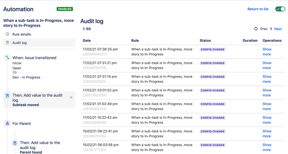

mmcneil February 17, 2021
Hello Jack! Thank you for your tip of the log action. I've added the logs now and tried to move my subtask but there are no logs or action which leads me to believe the trigger isn't firing as expected.
From my reading, "Parent" would be limited to make the main story and not the epic but that could be an improvement in my logic
The action is limited to a single project.

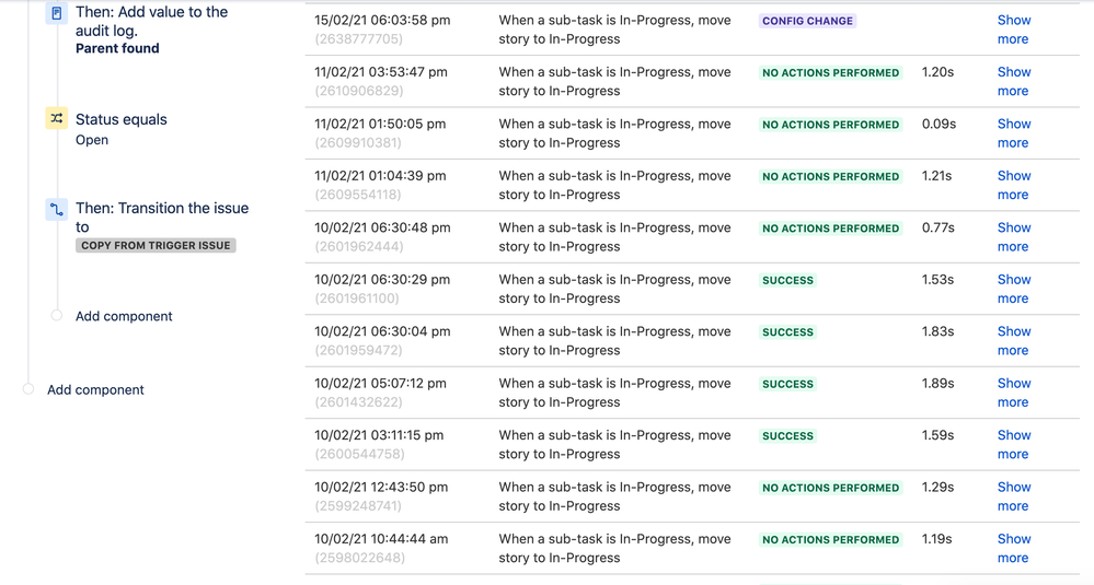

Jack Brickey
February 17, 2021

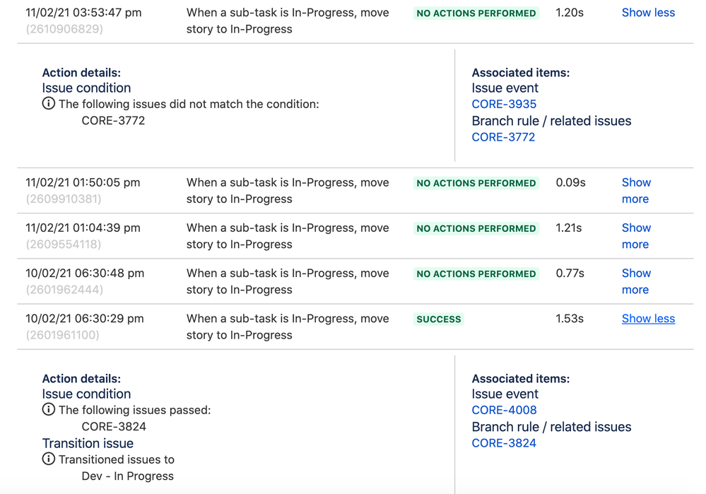

So I see a lot of config change entries but nothing after. I need to see a trigger and then expand the log.the last trigger at 3:53:47 shows no actions performed. Can you cause the rule to trigger and expand the log?
That's the issue, the rule no longer triggers. Here's a view of the last time it's triggered succesfully.
I've created a new story, add a subtask, and then moved the subtask in-progress but nothing in the audit log.
