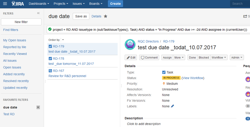

I have created a filter when due date is 2 d. Find below the filter project = RD AND issuetype in (subTaskIssueTypes(), Task) AND status = "In Progress" AND due >= -2d AND assignee in (currentUser()).
I have subcribed by email i have only recieved only 1 mail with saved filter. But when issues are due , i did not received any emails.

Does the filter show you the issues you expect to see when you run it in the issue navigator?
yes, i got a list of issues that will be due in 2 days.
