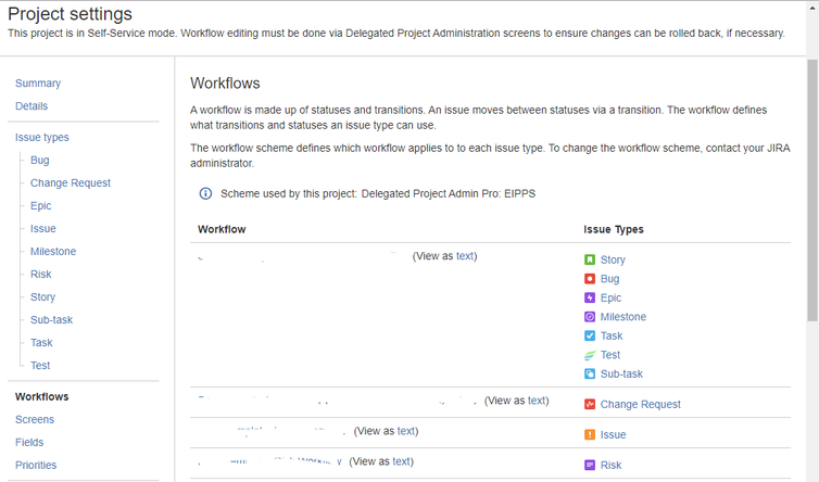

I want to confirm if this would affect the other existing workflow in our project settings. With the said issue type as "Story" created from the process template.
Would like to know how the process template relates on the project settings of Delegated Project Administration screen.

  1. Let’s assume Story , Epic and Task are tagged to Process Template A and Bug is tagged to Process Template B
  2. Copy the Template A to new template called Template C and Map Story issue type to copied Template C and this action reflects all configurations associated with Story Issue type to be copied to Template C. Now if you go and check your project settings--> workflows page you will see same workflow for Story , Epic and Task issue types.
  3. Once if you make a change to the workflow in Template C which is created for Story Issue type you will see that workflow is copied and new workflow gets created for Story Issue type.
  4. Also configurations associated with Epic and Task remains same with Template A and their workflow is different from the Template C.
