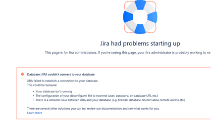

We have tried updating Jira from version 8.2.3 to version 8.18.1 and it updates fine but doesn't connect to the database.
I have reviewed the logs and it gives the following error:
  • 2021-08-12 18:06:48,156+0200 JIRA-Bootstrap ERROR      [c.a.config.bootstrap.DefaultAtlassianBootstrapManager] Could not successfully test your database:
    com.microsoft.sqlserver.jdbc.SQLServerException: El controlador no pudo establecer una conexión segura con SQL Server con el cifrado de Capa de sockets seguros (SSL). Error: "The server selected protocol version TLS10 is not accepted by client preferences [TLS12]". ClientConnectionId:18777f3b-e54b-4137-87ed-4c84ffa963a7
The connection is made via SQL on a Windows Server 2008 R2 server. What is happening? Is it because the TLS 1.2 protocol is not installed on the SQL server? I have created this protocol with a registry key with this procedure (https://clouding.io/hc/es/articles/360015569559-C%C3%B3mo-activar-TLS-1-2-en-Windows-Server-2008-R2) and it still does not connect.
I have also checked that this KB (https://support.microsoft.com/es-es/topic/actualizar-para-habilitar-tls-1-1-y-tls-1-2-como-protocolos-seguros-predeterminados-en-winhttp-en-windows-c4bd73d2-31d7-761e-0178-11268bb10392) of the TLS 1.2 protocol was installed and it has it installed.
Can you help me? Thanks.
Brant Schroeder
August 13, 2021
@Jesús Pastor Welcome the Atlassian Community
Before performing the upgrade you need to upgrade your SQL instance to a supported version.  2008 R2 is not supported.  Here is a list of supported SQL versions https://confluence.atlassian.com/adminjiraserver/supported-platforms-938846830.html
