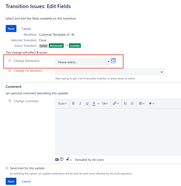

When I bulk change issues and transition them though our workflow from Resolved to Closed ( to remove them from my boards") i would like my issues to keep the resolution code they already were set with, when I resolved the issues.
But as it is now, I have to Change the Resolution when i move the status. I can't unmark the "Change Resolution" and I need to choose a new value, which overwrite the value that the issue already has.
Does anyone knows how I can change this, or if it is possible.

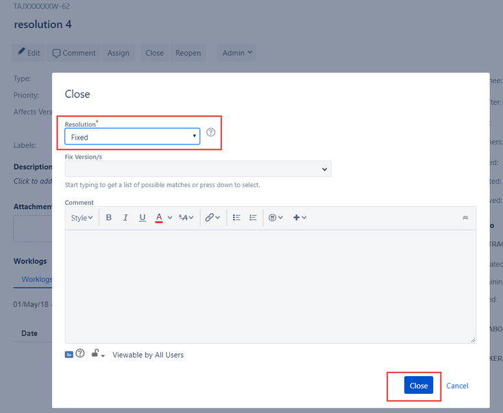

When I close the issue from the issue card, the resolution option is kept, without a force to change.
Unfortunately, there is no solution for this problem. Resolution field (when set on a screen) is always required and this cannot be changed (see also this question). This causes bulk edit/transition action to always require filling resolution (and therefore overwrite other resolution if they are different).

All Atlassian needs to do is to give us the same "Retain Value" option during bulk transitioning and it'll save a lot of trouble... Anybody might know why this isn't an option when it's available for other fields?

@Nic Brough -Adaptavist-I can see where you and Radek are coming from when it comes to the technicality of what being mandatory/option means, but do you know if there there's a reason why the "Retain Value" button doesn't exist for bulk transitioning (this ties everything back to the original thread)?
Resolution is being forced to be updated (regardless of an existing value) as long as Resolution is on the transition screen, which will screw up the meta data quite a bit if you're doing this with tickets with different existing resolutions.
Because your transition is set up to set the resolution to the value the person puts in the field. Retain values doesn't do anything because it's overwritten by the transition process.

The solution we went with, was to remove the field " resolution code" in our workflow in the transition between resolved and closed. Because we set it when moving the issue to resolved.
So @tom, we got around it by removing the fileds in the transistion. So we are doing as @Jack Brickey suggested.
