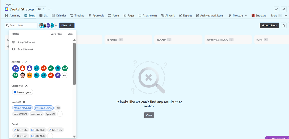

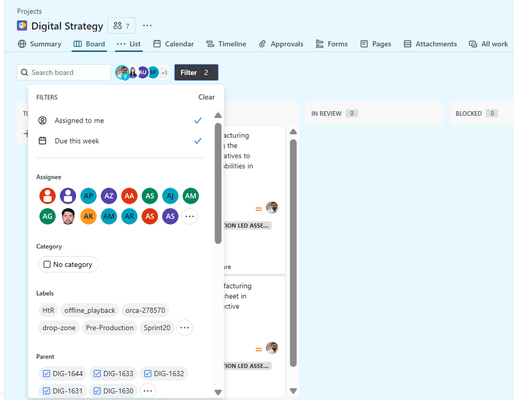

I am working on a team-managed project and I am having a hard time to apply filters. With reference to my attached screenshot, I am unable to apply filters on Due This Week and down below (like Assignee, category etc.). I can apply both filers at a time for 'Assigned to Me' and 'Due This week'.
Looks like there are 2 categories of filters (the first 2 and the rest below those) and its not possible to apply filters simultaneously in both the categories. Can anyone help me here?

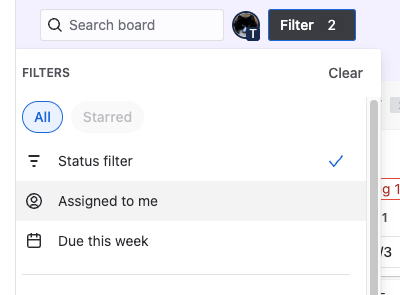

To create additional filters like the ones that show at the top of the filters dialog:

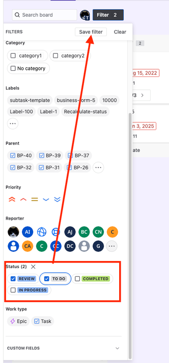

1. Select from the available options in the dialog to build your filter. The Save Filter option will then appear at the top of the dialog. Example:

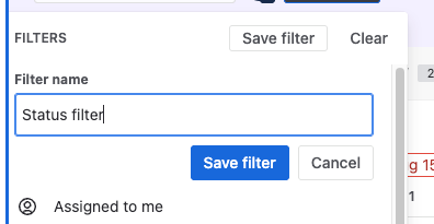

2. Click the Save Filter button and you will get a field to enter a filter name and another button to click to save it.
3. The filter will then be listed at the top of the dialog.

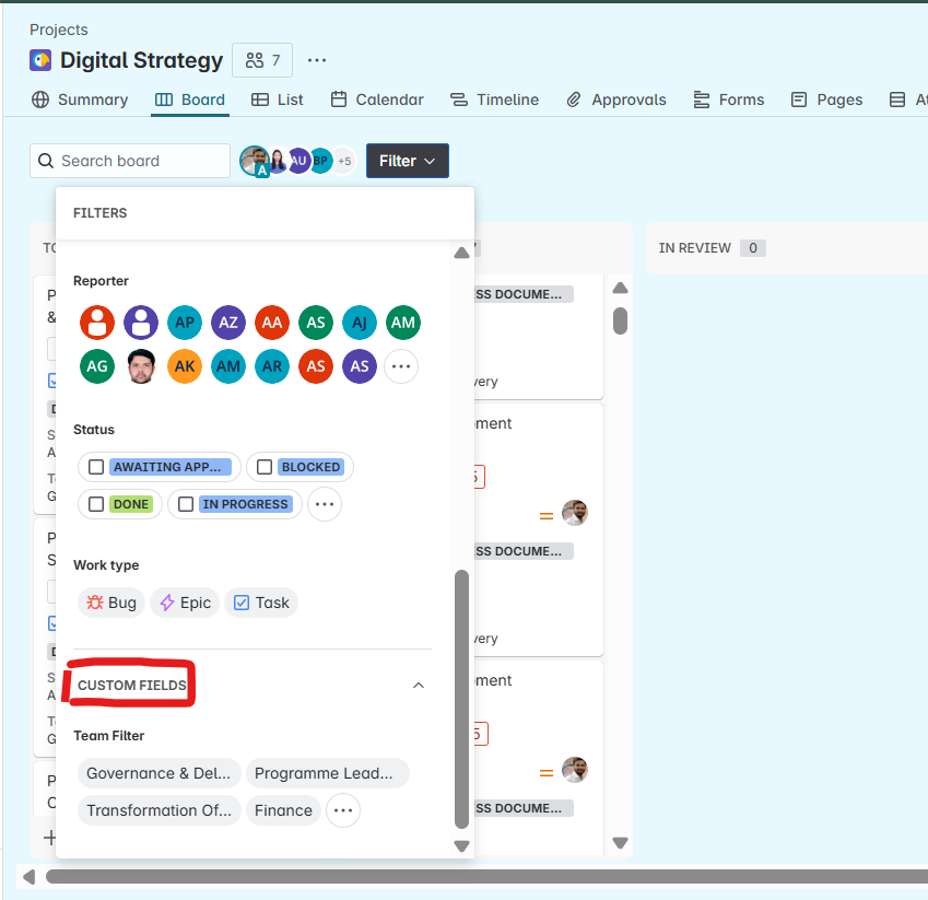

@Trudy Claspill I was thinking to create a custom field of due date range and then use it in the filter section on board. But I am not sure how to do this.
Just an FYI, I created a custom field (Team Filter) which has all the team members of my project and that I see in the filter section on board. See the screenshot.
