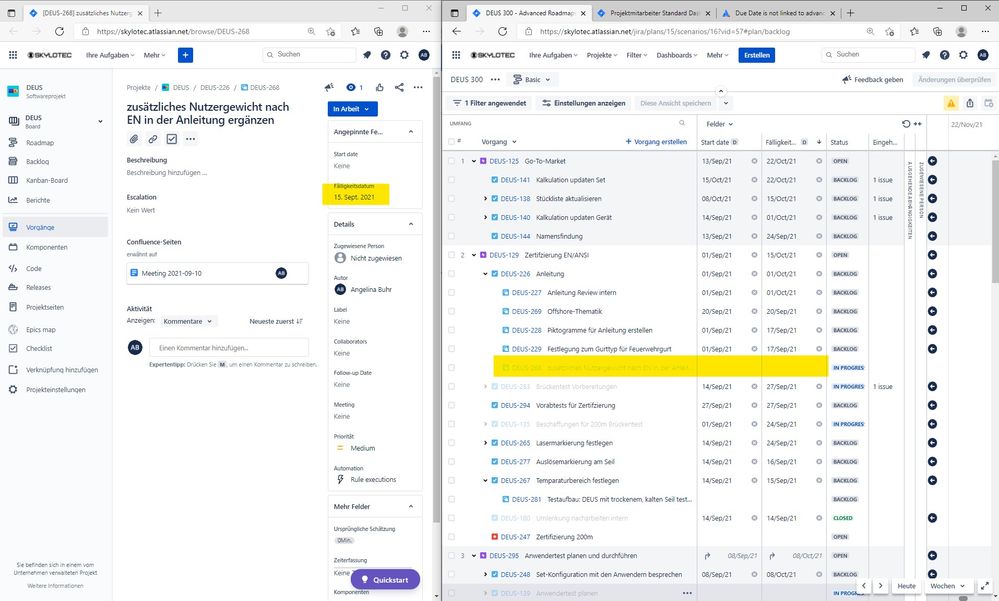

I am wondering why sometimes thoses informations are missing in the advanced roadmap. The advanced roadmaps shows that the due date is empty but this is incorrect- the informations are there?!
I also saw the same problems when using filters. Some issues are not shown even the due date is filled. Any idea on this?

Hi @Jacob Vu . Hi @Sara Hekmat ! Many thanks for your quick reply! Please apologize that my request was not that clear!
End date is just the name that I´ve been using to explain my problem. We don´t use end date instead of due date. We are only using the JIRA standard due date. The problem is not, that the due date is not at all visible in the advanced roadmap - the problem is, that the due date is shown up for some issues and for some not.
Please refer to the screenshot. As you can see: the most due dates are visible, some not.. But please refer to the left side to see that there is a due date in this task
Hi @Angelina Buhr, I couldn't figure out the issue with looking at the screenshots, it is very weird that only some of the due dates are not shown! I would recommend that you raise a support request via https://support.atlassian.com/contact/. Creating a support request will yield a faster response as a Support Engineer will be better placed to assist you here.
