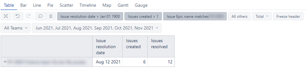

Thank you - that looks to work for me (I actually just used the 'Issue resolution date' measure), only question I have is around 'Issues created' as a measure. Is that right for showing child items?
Only for this particular Epic, there's differences in number created and number resolved:
When I look the Epic up in Jira, there are actually 11 child items...
Both measures "Issues created" and "Issues resolved" would also include epic itself if you use them with epics from "Issue.Epic"
That is why I recommended earlier using the "Epic Link" dimension to not include epic itself.
But to answer the difference between both measures. each of two numerical measures in your report is independent.
If you filter the report by time, eazyBI would count how many issues were (tied to Epic) created (regardless of resolution details) in the filtered period, and how many were resolved. For the "issues resolved" measure, it doesn't matter when they were created as long as they were resolved in filtered period.
It could be that for your epic (in rows) there were just 6 children (or 5 children + epic itself) created between Jun 2021 and Nov 2021, but 12 (11 children and epic itself) were resolved in the same period. I would guess that some of the children for the epic were created before Jun 2021 but they were resolved in the selected time period.
Martins / eazyBI

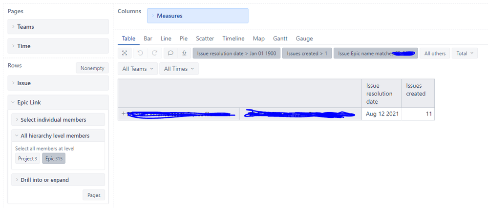

Ah ok - yes that makes sense. I have removed that element from it and can now see what you mean :)
I now have the Issue name twice in my table though:
is there something I'm doing wrong?
I think you need to use just the Epic Link dimension in report rows.
Then create new calculated measure using this formula:
[Issue].[Issue].Getmemberbykey(
[Epic Link].CurrentMember.key
).get('Resolved at')
It will return the epic resolution date when "Epic link" alone is used in the report, because "Issue resolution date" (predefined measure) wont work with "Epic link" dimension.
