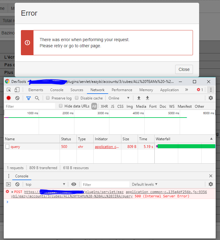

I really love EAZYBI plugin but recently I am facing issue which is very inconvenient.
When I select the "Drill through issues" button, very often, this pop-up is displaying :
I initialy thought this was due to large number of issues, but :
- It also happened with just 5 or 6 issues
- On this page I see that even with 919 issues, everything is working and very quickly.
I tried to check logs files and understand where the problem can be. This is what I found :

2019-12-12 10:19:54 +0100 INFO: [B97C2819:7d569ae8] Completed 200 OK in 14868ms (Views: 1.1ms | ActiveRecord: 3.4ms)
On my browser I see that the request seems to Timeout at 5s :
So at 5s the pop-up said that an error occured, but at 14s one 200 success code appear on logfile.
I don't see some errors in others logfiles.

- Why is my request on 3 issues takes more than 14s ?
- Why is EAZYBI so impatient?
Maybe @eazyBI Support can be very helpfull on that ?

Please, contact eazyBI Support (https://eazybi.com/contact) when you experience an error like this. The cause of the error might be different for each individual use case.
To the support requests include:
1) collect eazyBI log files (https://docs.eazybi.com/eazybijira/set-up-and-administer/set-up-and-administer-for-jira-server/troubleshooting#Troubleshooting-eazyBIlogfiles)
2) generate the HAR file (https://docs.eazybi.com/eazybijira/set-up-and-administer/set-up-and-administer-for-jira-server/troubleshooting#Troubleshooting-HARfile).

Please generate the HAR file and send it to the eazyBI support with the eazyBI log files archive for inspection.
