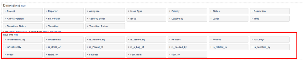

Hello @Lauma Cīrule, once the links are imported how can I proceed to have a report that shows, two issues types with a specific link type, for example:
Total Customer Req that are linked/or not with User Story through the link type "satisfies"
Total User Stories that are linked/or not with Customer Req through the link type "is satisfied by"
The way that Support Team imported the links as dimensions is the following:
Hi @Mario Andres Moreno Bulla !
In this case, I would suggest going one step further and defining a new hierarchy in the Issue dimension as well. See https://docs.eazybi.com/eazybijira/data-import/advanced-data-import-options/additional-issue-hierarchies.
