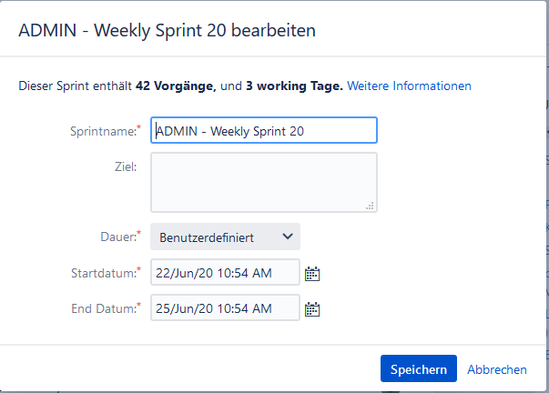

Can you confirm if you have the option "Sprint Beenden" under the three dots menu and check if it provides you with the display to edit the start and end dates?
If that's the case, please vote and watch the bug to increase its priority and also receive notifications about any updates.

thank you very much! I can confirm, that's the wrong translation. "Sprint beenden (End Sprint)" opens the "Edit Sprint" menu.
I will vote for the bug - but your comment solved my problem as a workaround.

Hello @Petter Gonçalves : Thank you very much, this is indeed the issue :-)
I upvoted the corresponding bug as you said.

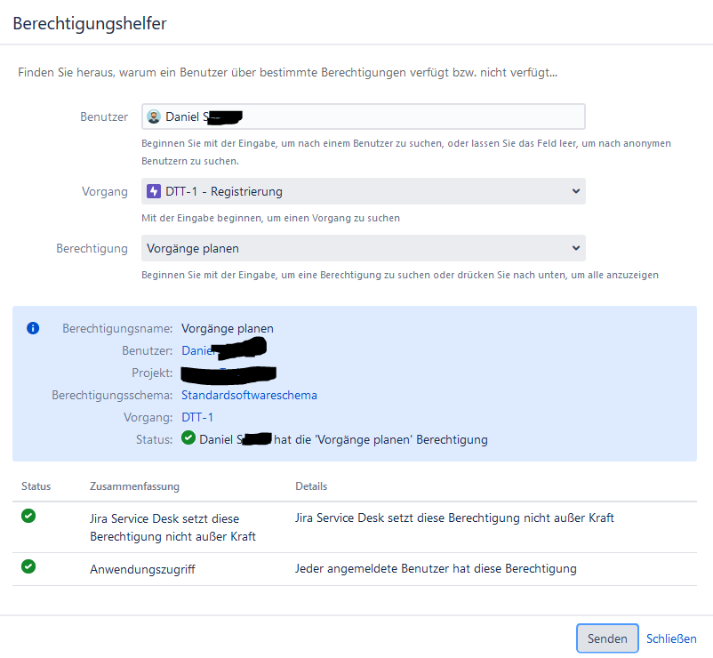

3. The permission helper shows this:
Additionally I ran the integrity checker and it even found a permission problem, though fixing it didn't help in any way and the problem still persists.

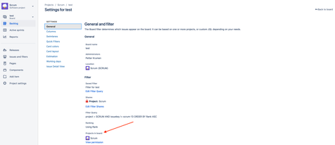

 To allow the management of a specific Sprint in Jira, the user must have the Manage sprints and Schedule Issues permissions in all the projects returned by the board filter where the Sprint is located.
That being said, I believe the problem you are facing is probably caused by an update in the board filter or in your project permissions. These would be the steps to fix it:
  1. Navigate to the board where the Sprint is located > ... > Board settings > General
  2. Check what are the projects returned by your board:
  3. Navigate to each one of the projects and add yourself with the Manage sprints and Schedule Issues permissions under Project settings > Permissions or ask a project admin to add you with those permissions, as mentioned in the documentation below:
    Managing project permissions
  4. P.S: If you are using a complex filter in your board and Jira can not identify which projects are related to your filter, you must be added with the mentioned permission to ALL the projects in your site, or simplify the board filter.

  3. Provide us with another screenshot from the permission helper (Under Project settings > Permissions) in the same project of the board, as the one displayed below. You should select the following details:
    - Your user
    - Any issue returned by your board filter
    - Manager Sprint and schedule Issues permissions
