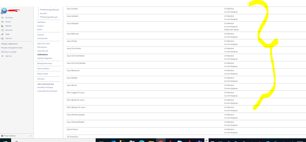

Though user is not a watcher or assignee getting the notifications for the project. Currently i have configured the Notifications only for Current Assignee & All watchers. I have attached screenshot for your reference and let me know what went wrong for getting unwanted emails ( Not a Assignee, watcher ).
NOTE : I have set a Email ISSUE ( PoST FUNCTION ) to only 2 workflow transitions but user is not there is this set up.
Can someone pls advise me ASAP. As client is fed-up on receiving unwanted emails.

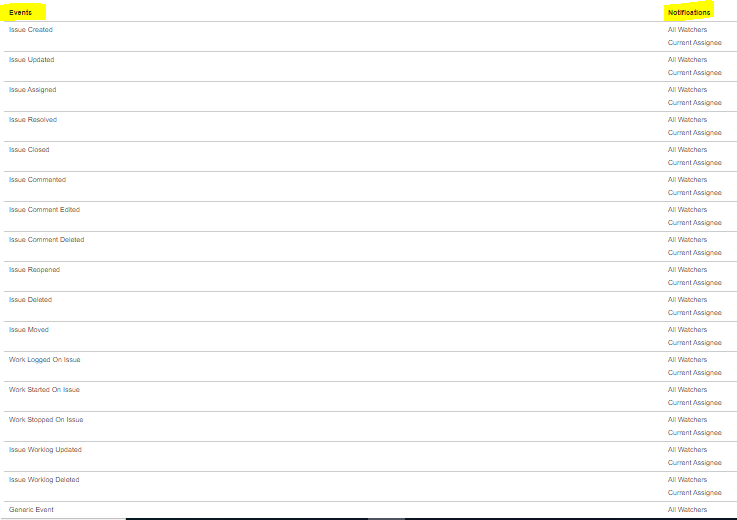

After following the steps based on the above article looks like USER is not receiving notifications for any of the events. Attached Project Notification Scheme, Notification helper snippet ( which i tried )for your reference.
2) Also how to disable notifications for specific Events like Issue Created, Issue updated etc.
3) And how to enable Notifications for SPECIFIC EVENTS.

IS this a question to me if so, yes configured on the notification scheme. Attached screenshot for your reference.
