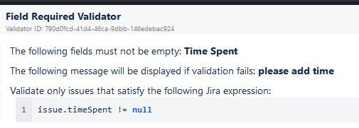

If you want to check if at least 1 hour has been logged in the issue, then use the following Jira expression:
issue.timeSpent != null && issue.timeSpent >= 60*60

That will ensure that time is logged before the transition can be completed. On the other hand, if you want to ensure that time is logged during the transition (if you have a dedicated screen and added the Log Work field), you can check against originalIssue—which is a snapshot of the issue before the transition screen was opened:
originalIssue.timeSpent == null
? issue.timeSpent != null
: issue.timeSpent > originalIssue.timeSpent

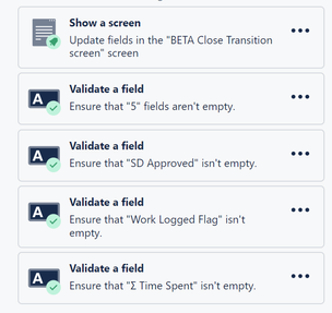

Of course, here is the workflow, transition is from final estimation to closed.
The screen shows
1. The workflow - the transition is from 'Final Estimation' to closed.
2. The transition configuration
3. Screen configuration
I added a transition screen to my workflow and put the Time Tracking field on it. I still have the Validator to require the Sum Time Spent field.
With no time logged against the issue I try to transition it. The Screen with the Time Tracking fields displays. I do not enter any time, and I try to complete the transition. I get an error that Sum Time Spent is a required field.
Exit out of the transition and log time agains the issue. Then try the transition again. The transition screen displays, but I enter no time there. I am able to complete the transition because the Sum Time Spent was updated by my earlier Log Work activity, before I attempted to transition the issue.
On another issue with no time previously logged, I try the transition. The transition screen displays and I enter time spent. I try to complete the transition. I get the error that Sum Time Spent is a required field.
This is expected. The Sum Time Spent field is not updated until the Log Work activity completes. The Log Work activity done through a transition screen is not completed until the transition Post Functions run. The Validator executes before the Post Functions. Subsequently the sum of Time Spent is still zero at the time the Validator executes.
To use the Sum Time Spent validator the issue must have time logged prior to starting to transition the issue. You can't use the Sum Time Spent validation to force and accept a time log entry that is part of the same transition.

JMWE: its not that difficult and you don't need to code. But for doing both with JMWE, you will need to use the inbuilt script creator or Jira expression.
With the field required validator you request to add values to the field and then a conditional (with Jira expression) to check if the field is empty or not.
example (you can test the expression) here the time tracking was empty. so the test was FALSE. then I added 1h, tested it again and now is TRUE.
