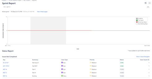

@Ravi Sagar _Sparxsys_ For some reason the sprint report doesn't show Completed issues when we tried today. Any ideas?
Sample I:
Sample II (worked one week ago):

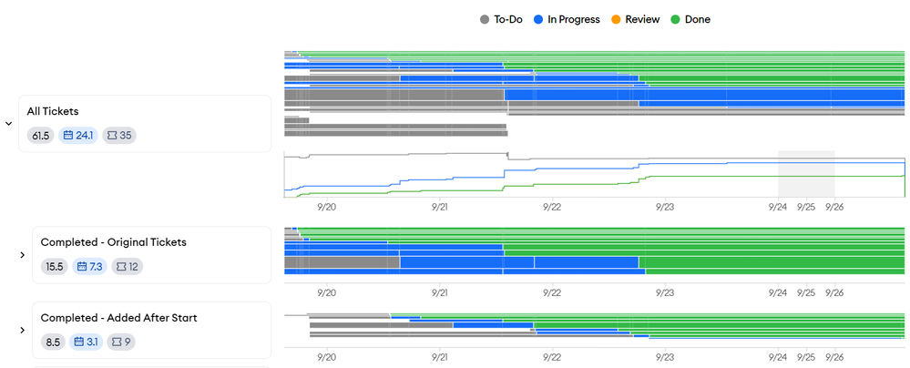

We can help at minware - here is an example of the grouping for issues / tickets and would be easy to do something similar for epics if you want to discuss your requirements:

The issue solved! Apperntly the problem that we encountered with was connected to the face that the board's statuses weren't in a good order (done should be on the RIGHTEST spot between the statuses).
Now the data is fixed and we managed to create good reports in eazyBI as well.

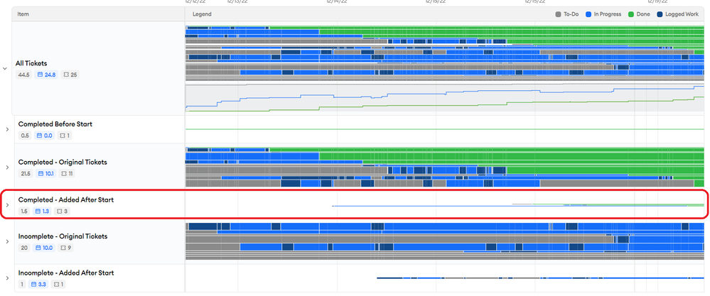

(1) https://jira.atlassian.com/browse/JRACLOUD-75868 <- tickets added after the start of a sprint

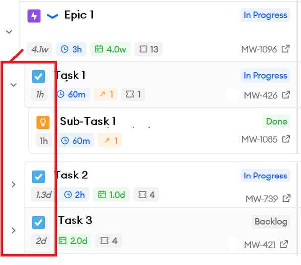

(3) https://jira.atlassian.com/browse/JSWCLOUD-18677 <- drilling down to subtask level
These are available "out of the box" in minware due to our ability to blend Jira + Git data as well as a ton of other metrics to help your teams improve estimation.
(1)
(2) / (3)
