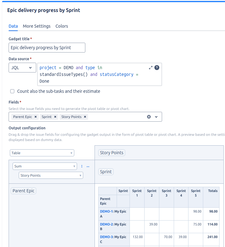

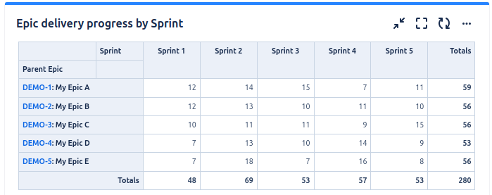

If you consider the option of using an add-on, our Great Gadgets app has a Pivot Table & Pivot Chart gadget that will allow you to display the epic delivery progress by sprint- it works just like pivot tables in Excel and allows you to display data in form of table, heat-map tables or charts.
To obtain this, the gadget should be configured like this:
Unfortunately it is not possible to display Total and Remaining in the same table/chart.

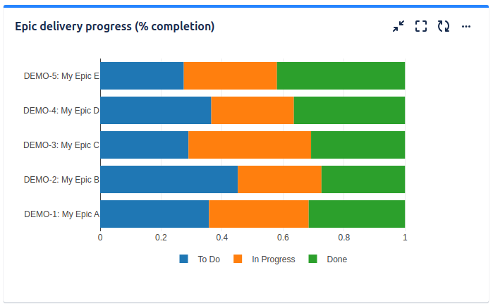

But you can configure a different instance of the gadget to display the overall epic progress by sum of story points of percentage completion.

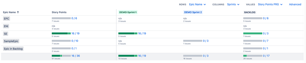

It's kind of possible to achieve but strongly depends on how accurate and well organized your data is. Couple of thing to keep in mind:
- sub-task can't be assigned to sprints directly. Instead they are using parent sprint
- if a story/task has multiple sprints (drifting between sprints), it becomes really tricky to map that progress correctly. Especially with the comment above, if you have multiple sub-tasks, completed in different sprints
This being said, you can take a look on Pivot Report we develop. I don't have accurate demo data, but here's what you can get in several clicks:
We can schedule a call to go over the demo if needed. Hope it helps!
