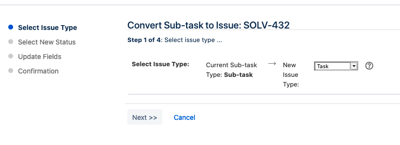

This is what I'm doing:
Step 2:
(the same error happens for all issue types I can select)

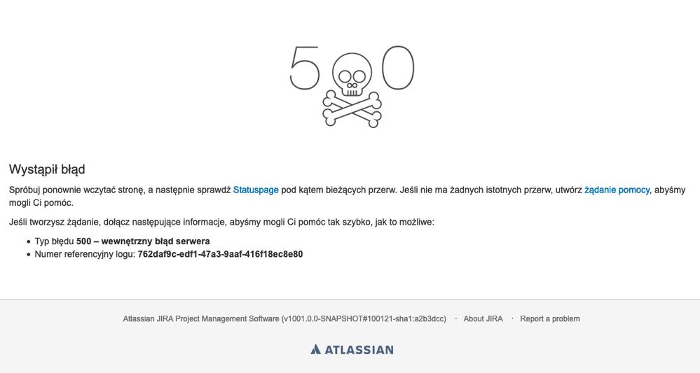

And the error:
