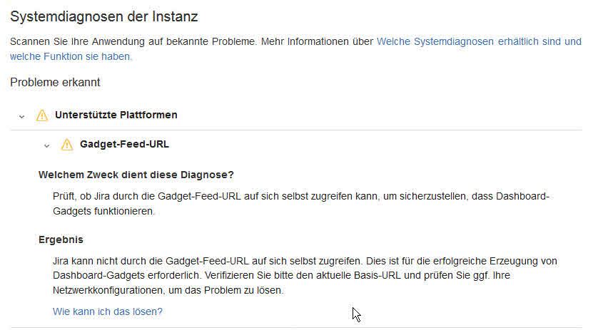

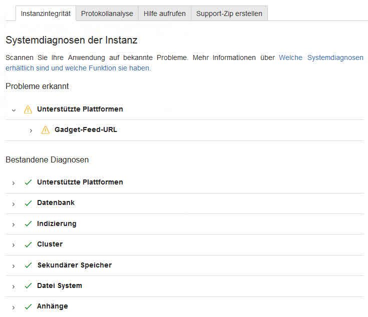

After Upgrade Jira 7.2.4 to 7.7 we get an error at the Error search and supporttools Screen.
"Gadget-Feed-URL"
But, all Gadget work fine. They start fine and adding Gadgets from Gadget catalog work fine as well.
How i can remove These error massage?
All "Health Check: JIRA Base URL" issues are fine. But we still get the Error.

Heiko,
I'll need to see more details about the errors to know what's going on.
Is it possible to expand the "Gadget-Feed-URL" item under Systemdiagnosen der Instanz?

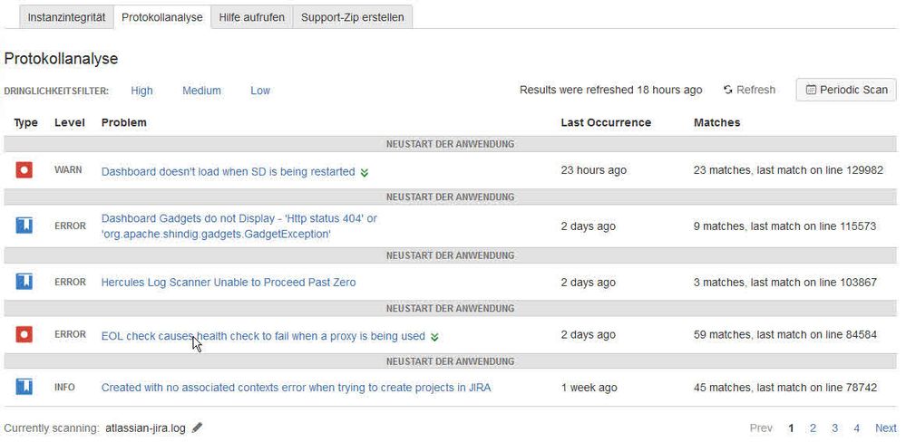

Are you able to check your Jira logs to see what exactly the line says that it's referring to?
Shannon
SMS
January 24, 2018
Hi Heiko,
Any way we can see a screenshot of the error you're getting?
Could you see if there are any errors in relation to this in your Jira Server Log as well?
Shannon
