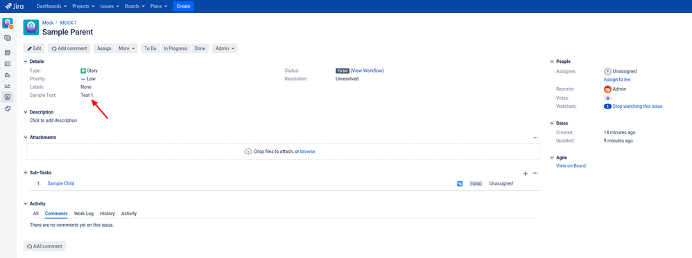

1) The parent issue with the value for the custom field:-

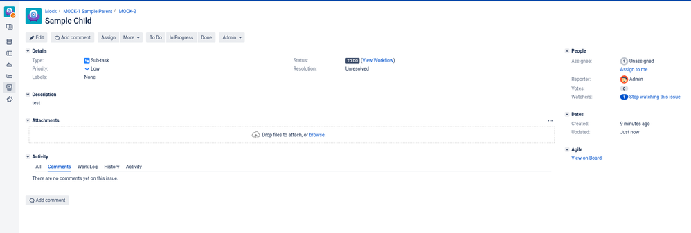

2) The child issue without any value for the custom field:-

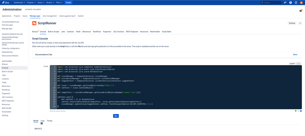

3) Executing code in on the script console:-

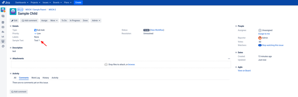

4) After executing, the child issue is updated with the same value of the custom field as the parent issue:-

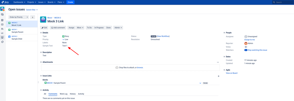

Below are a few test steps.

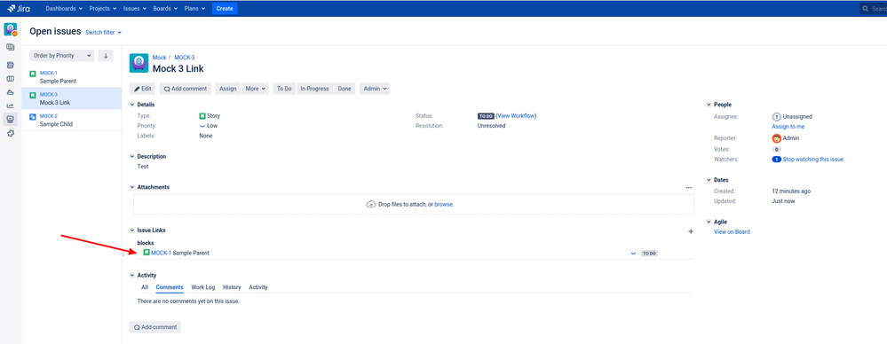

1) In issue MOCK-3 which blocks issue MOCK-1, no custom field value is added. MOCK-1 is the same as per the example above and already has value for the custom field.

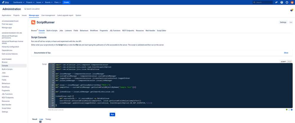

2) Below is a print screen of the script console:-script_console2.png
3) After executing the script on the script console below is the updated custom field on the linked issue:-
I hope this helps to answer your question. :)
