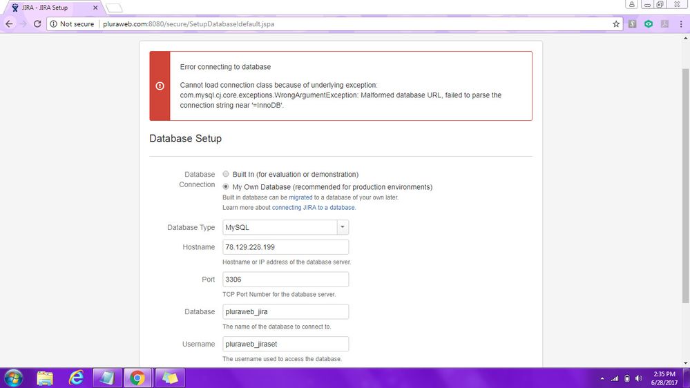

Dianna Newman June 28, 2017
I don't see any dbconfig.xml file under Jira. I see a lock file.
Here is a photo from my screen
Nic Brough -Adaptavist-
June 28, 2017
Ok, it's not been able to connect, so it has not created the dbconfig file.  I sort of expected that, but had to check.
The parameters you are entering look good to me, so I'm not sure what is wrong.
Next thing to do is a look at the log file, which should tell us the full reason for the failure and contain the string it has constructed to try the connection.  Should be under "logs" in the directory you found the lock file.
