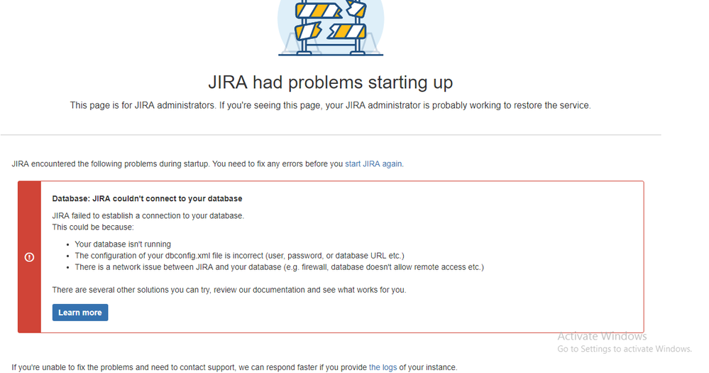

Could you please share with us error message or screenshot for the same.
kapil kinikar August 20, 2018
Sure, Please see attached screenshot
Yogesh Mude
August 20, 2018
HI @kapil kinikar
As mentioned in the error screenshot please check whether the Database is running or not and the confirm that have you been provided database details are correct?
