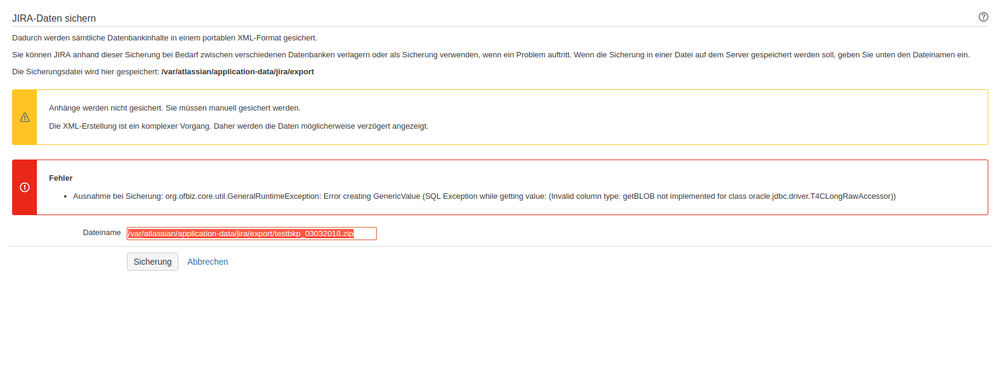

When I start creating a XML-Backup of the DB, I get the following error:
I used this documentation for the DB-migration: https://confluence.atlassian.com/adminjiraserver071/switching-databases-802592192.html
I've attached a screenshot and an actual support-zip-file.
Do you have any hints?

I would start with https://confluence.atlassian.com/jirakb/invalid-column-type-getblob-not-implemented-for-class-oracle-jdbc-driver-t4clongrawaccessor-during-backup-process-854131615.html and if you need more help, contact Atlassian Support
