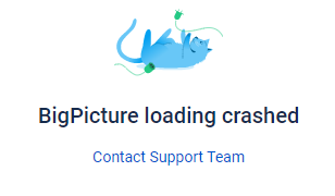

I prepared for a Jira Server Upgrade by also taken a snopshot of BigPicture (V) to be on the save side. But After Snapshot done, BigPicture is showing this and is totaly out of order:
I already checked this BigPicture loading crashed (softwareplant.com), run the Jira Upgrade, run the BigPicture upgrade, deleted Cache, everything fine, but not BigPicture.
1. BigPicture SnapShot -> done -> BigPicture loading crashed
2. Searched Log files regarding BigPicture loading crashed (softwareplant.com) -> no indication
3. Run Jira Server Upgrade 8.21.1 -> 8.22.3 -> still BigPicture error
4. Run BigPicture Upgrade 8.4.7 -> 8.5.1 -> still BigPicture error
5. Cleared Cache .osgi-plugins .bundled-plugins, work and pluginstate -> still BigPicture error
I already raised a ticket at softwareplant, but no solution so far. Hope somebody may help with this.

Based on BP developers, you have to
1. remove the snapshot files from
{JIRA_HOME}/export/softwareplant/bigpicture/backup
2. disable + enable the BP Add-On
That worked for us.
Rgds Ivo

Hi @Mayur Jadhav
thank you very much for this input.
I did run a SELECT in advance and in our table there are no records to delete. I also tried disable + wait 10' + enable and still get the above error with no entry in the logs.
