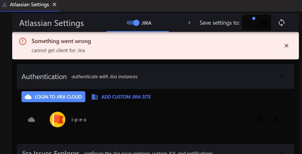

Error using Atlassian extension in VSCode: "cannot get client for: Jira". Same for Bitbucket
mgoldbach_nsr
May 29, 2023
Error using Atlassian extension in VSCode: "cannot get client for: Jira". Same for Bitbucket.
I have uninstalled and reinstalled several times.
Authentication into Jira and Bitbucket appears to succeed.

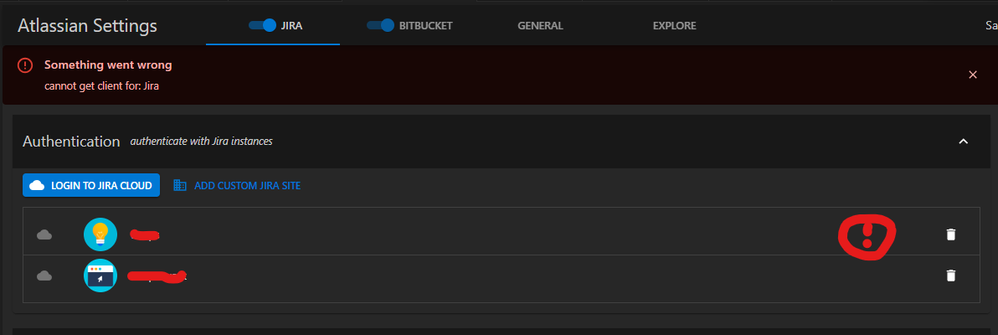

Kristian ASK August 5, 2024
In the settings for the Atlassian extension there is a collapsed section called Authentication. Expand that and click the little exclamation mark icon. It will take you to the site where you need to update the authorization.
mawi
August 16, 2024
The odd thing is, in my case, I do not see any exclamation mark.

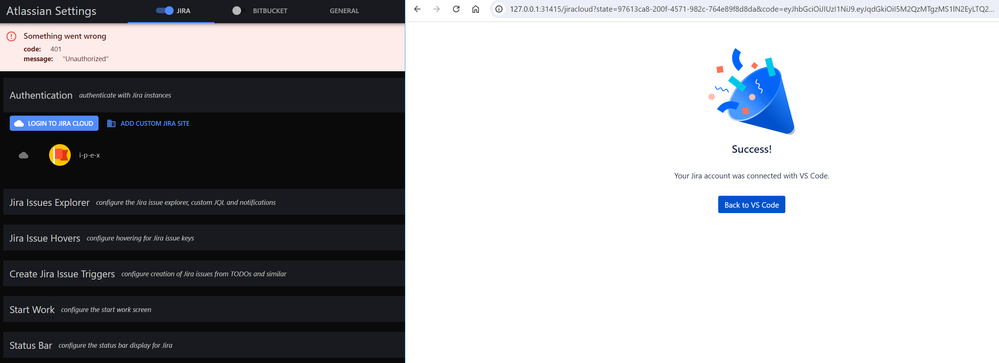

Tried again today. Got a 401 (new message), oddly enough.
One window says "Success!" (auth flow), the other then says "Unauthorized".
And ofc, no logs or anything further to understand the issue.

Still have the same issue with Jira. I read all comments here and tryed the most complicated.
After unauth+auth+close window before Back button+click Back to VSCode I get another error ;)))
Something went wrong
code:401
message:"Unauthorized"
