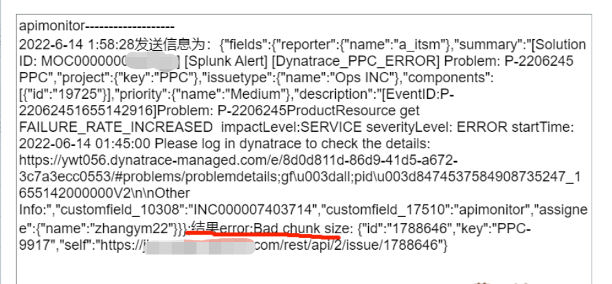

"Bad Chunk Size" error when other platform calling Jira API. The Jira issue key didn't reply to the platform. Is there anyone who knows about this?

Charlie Misonne
October 17, 2022
Hi Jason,
I don't think I really understand what you're dealing with exactly.
I missed the part where you said "other platform". Do you see the "bad chunk size" in the UI of that other platform?
Can you post a screenshot?
I also found this related bug report. Perhaps it is related to your issue.
https://jira.atlassian.com/browse/JSWSERVER-20190

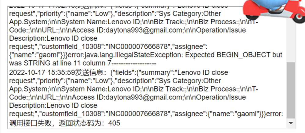

Jason Liu
October 17, 2022
Hi Charlie, it's like this.
Jason Liu
October 17, 2022
Hi Charlie, we also met some other errors, such as 405 when using automation calling. But manually calling the API to create Jira issue succeeded. Is there any unstable system reason or else?微信截图_20221017155910.png
Charlie Misonne
October 17, 2022
Hi Jason,
What do you mean with "automation calling"? I don't understand how you are making those http requests. if they are being made by another program I assume that program is not properly creating the requests.
405 response means: method not allowed. For example: doing a GET when it should be a POST.
Bad chunk size: could be a bug like https://jira.atlassian.com/browse/JSWSERVER-20190 or a very large request that can't be handled by Jira.
