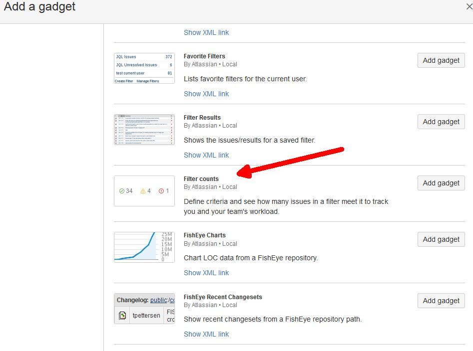

I get the following error message when trying to add the 'Filter counts' gadget to a dashboard:
'Unknown error occured initializing this gadget'
Does anyone know how to fix this?

The gadget is signed with 'By Atlassian • Local', so I assumed it's a standard Jira gadget and not made by an external provider.

Ok. I don't recognise "filter counts" as a standard Atlassian gadget - could you give us the actual name of it?
I see the same error - is this new gadget not available for the cloud?
I also see this error. Also on Jira cloud, and also see it is marked as an "Atlassian | Local" gadget.
I'm just setting up the system dashboard, and I've added a couple other gadgets successfully. This one gave me the error immediately.
Yep, I'm getting too, on one of the Cloud accounts I help out with. But not two of hte others.
