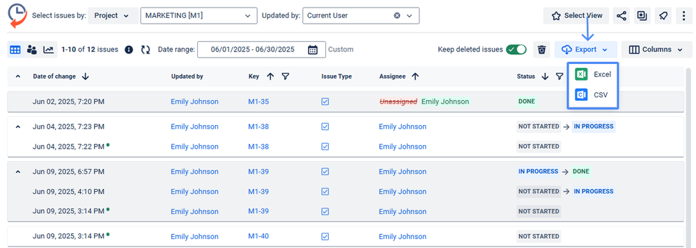

If you decide to try a faster no-code solution, I recommend paying attention to Issue History for Jira app. It allows filtering specific issue fields and exporting their changes in Excel or CSV formats.
