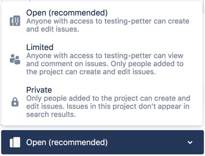

The clients you mentioned do have a valid JIRA user on your site? If they have, you just need to navigate to your next-gen projects > Details > In the Access field, select private:
Then, add the users that might have access to the project under Project settings > People.
P.S: The users added to the project will be able to view, edit and create issues. For those who are not added to the project, they will not be able to view issues or do anything.

Next-gen projects permissions work in a similar way that Classic projects, the only difference is that Next-gen projects do not have a permission scheme to set each specific permission in the project, instead, it defines which actions the users will be able to perform by role: Administrator, Member or Viewer.
To restrict your Next-Gen projects to only specific users, you must follow the steps below:
- Navigate to your next-gen projects > Details > In the Access field, select private:
- In the tab people, define which users should be able to access the project, selecting the role you want for them.

If I understand your question correctly, you want a user to only view one specific Next Gen project. The solution I did was to put all existing projects into private mode and added that one user to the project he should have access to.
In this solution, the user will only be able to view projects that he/she is granted access to.
