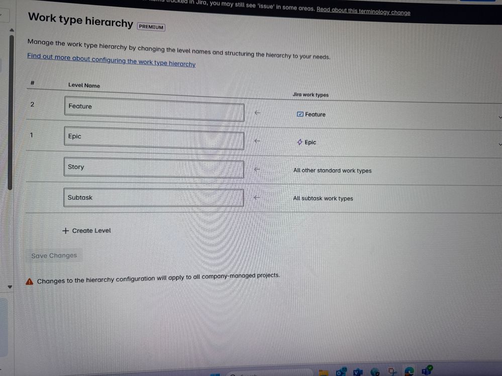

do not have a screen shot but the admin sent this.
Current hierarchy
Initiative: 2
Epic: 1
Feature, Story : 0
Sub-task, Auto Request, Software License Request, Technical Task: -1
For my purpose what I need is this:
Initiative 3
Epic 2
Feature 1
Story 0
Subtask and everything else -1
Issue is, other boards or projects are using Feature and Story as sibling, as children of Epic. If we change the hierarchy to what I want, then others will lose the current parent child relationship they have.

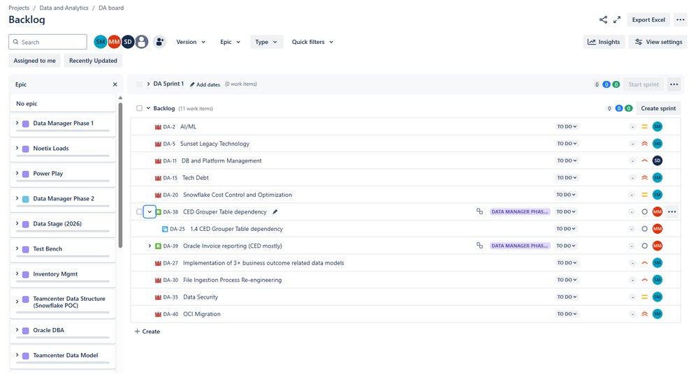

Any idea, why Backlog is not showing the hierarchical relationship from Initiative down to the Sub-task for all the Initiatives I have? It was working fine before Initiative was introduced to my board as a parent of Epic.

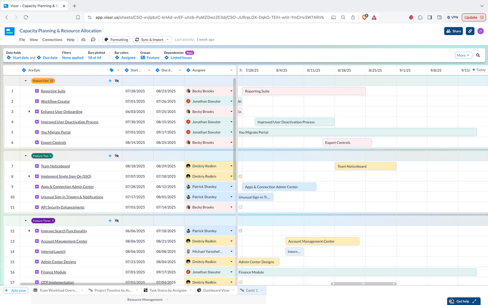

E.g. the example below where I've created a Gantt chart in Visor, and grouped my epics by a custom Visor field I created called Product.

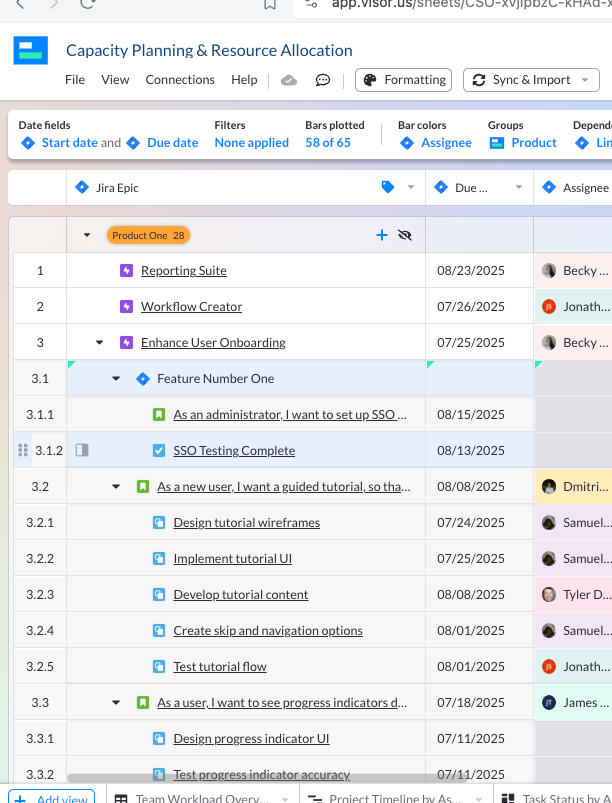

2. In Visor, drag and drop your Features issues below the matching epic, and drag your stories below the matching Feature (see closeup screenshot below)
