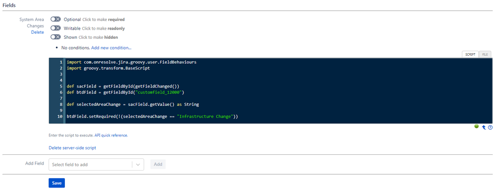

I used this script in behaviours in ScField
def ScField = getFieldById(getFieldChanged())
def TmField = getFieldbyId("customfield_11900")
def SAC = ScField.getValue() as String
TmField.setRequired(!(SAC == "c"))

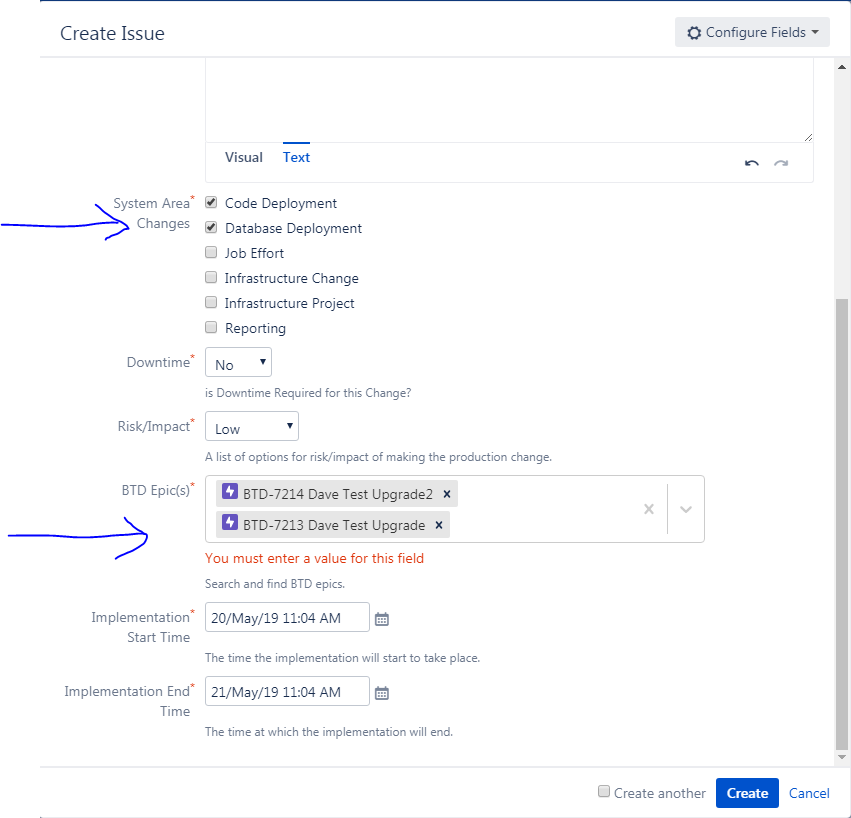

The Problem i am having is even though when TmField becomes mandatory and has a value in it. when i tried to create a issue. it says "Please enter a value in this field".

Could you please share your exact script and a screenshot of the behaviour configuration ? It would make it easier to debug.
Antoine
Hi @Rahul k ,
I think your screenshot displays an expected result since BTD Epics should only be optional when Infrastructure Change is ticked.
I tested your script and it works fine. However it seems that it triggers when the checkbox is updated, but not at form load. So you might want to add this script in the initialiser, using the id to get sacfield.
