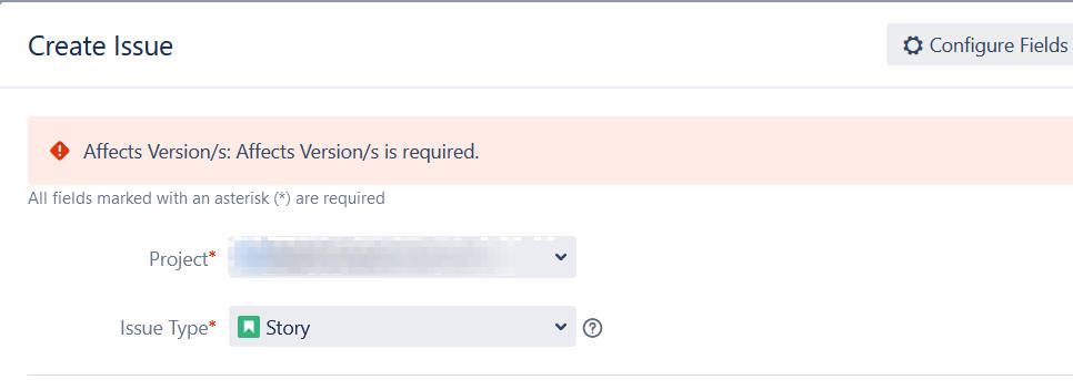

I tried ,but still confused,like this:
This filed is only configured in Epic Screen,but when I save the Store it stll says "Affects Version/s is required."
In fact ,this filed does not actually exist.
