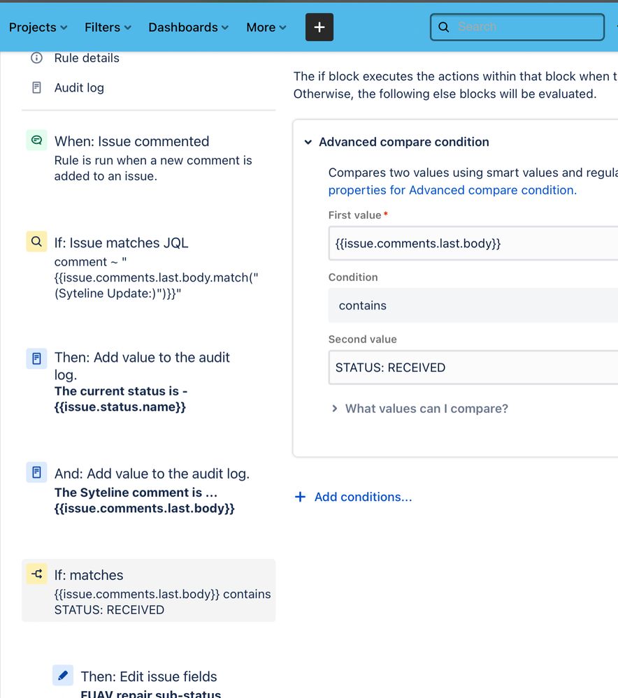

Email is not a good option for completing fields. However, one option to consider is using Automation and parsing the body of the email. Obviously this demands that the body is reliable which is rarely the case unless the email comes from SW-systems.

The email would come from another platform, with a format defined by me, I can leave the email body predefined with the information that jira needs but I don't know how to make the email body to fill the jira fields.
Here is an example of where I inspect the comment and take an action. You can similarly inspect the description and then use smart values to update fields. You can find the details on automation at support.atlassian.com just search for “automation smart values”.

There are other solutions via add-ons but OOTB automation is the only means. The trigger is issue created in your case and one condition is that it came in via email and then inspect description.
