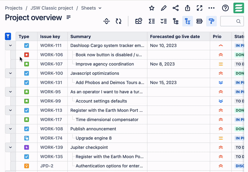

Just to expand on the last point, this is how this would look in the app that my team and I are working on, JXL for Jira:
JXL is a full-fledged spreadsheet/table view for your issues that allows viewing, inline-editing, sorting, and filtering by all your issue fields, much like you’d do in e.g. Excel or Google Sheets. It also comes with a number of advanced features, including support for (configurable) issue hierarchies. These issue hierarchies can be based on Jira's built-in parent/child relationships (like task/sub-task) and/or based on issue links. With this, you can build a view like the one above in just a couple of clicks.

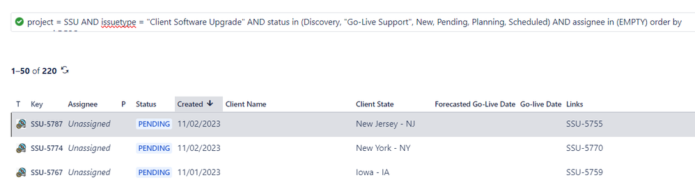

This is what I have so far for the JSQL. Basically, I'd like to add another column that would be the Forecasted Go-Live date of the Linked issue.
project = SSU AND issuetype = "Client Software Upgrade" AND status in (Discovery, "Go-Live Support", New, Pending, Planning, Scheduled) AND assignee in (EMPTY) order by created DESC

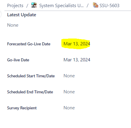

Jennifer Hart November 6, 2023
It isn't a calculated field. It's just one of the date fields in the linkedissue.SSU.PNG
