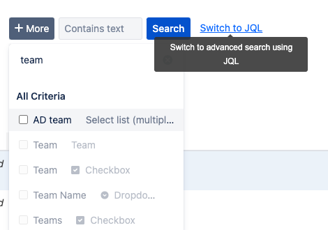

When I try to update the Filter for my board I am unable to select team as a criteria. It says the following error message: "Team is not applicable for the current project and/or issue type"

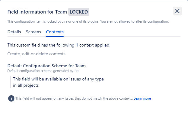

However, when I look at Issues > Fields > Custom fields and go to "Team" it says the following for its context requirements.
So it seems to me like there's no reason I shouldn't be able to filter by Team?

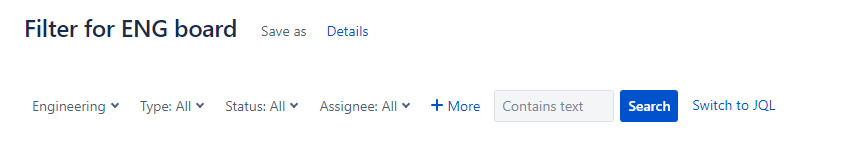

Here's the filter:

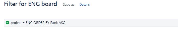

And here's the JQL if that's easier:

Can you show us the modified filter with the Team field and the error message?
When you are looking at the custom field, there can be Context and Screens specified. You showed us the Context. Is there anything for Screens?

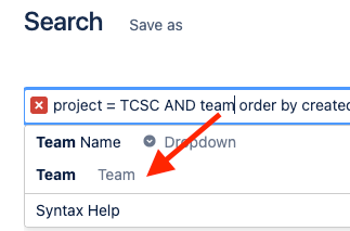

Not sure if this is what you're asking for, but I'm having what sounds to be the same issue as folks above describe; Team field not available in Filters.
