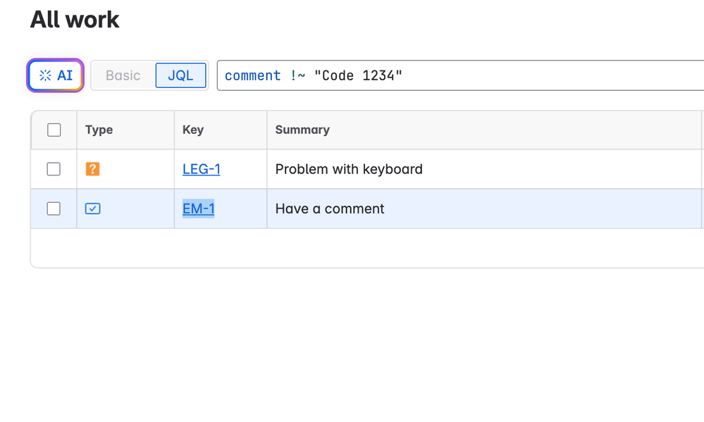

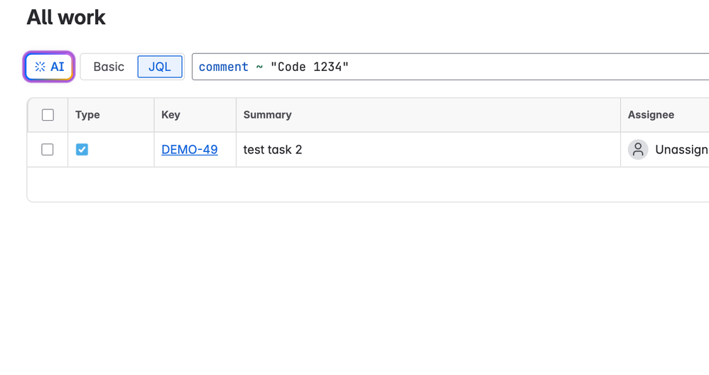

I am trying create a filter that list all issues that do not have specific text (e.g Code 1234) in the comments section. I have tried comments !~ "Code 1234" with no success but I do get results with comments ~ "Code 1234" (though not the results I am expecting)
