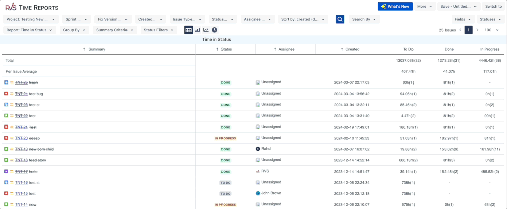

If you are fine to try out a mktplace app for this need, pls do take a look at
Time in Status Reports
The "Time between status Transitions" report can meet your requirement. You can easily filter your issues calculating the time between 2 specific statuses in the issue workflow which will help you track the time from created to resolved state. Also the app has 20+ reports to meet a variety of use cases.

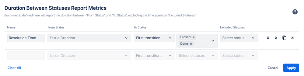

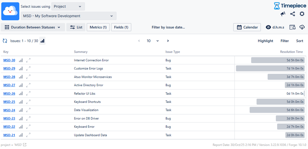

Full disclosure, I'm on the team that makes Timepiece - Time in Status for Jira, and it's designed to give you this exact data.
Instead of a JQL function, you would use our Duration Between Statuses report. You can configure it to calculate the exact time from issue creation to resolution for every item in your filter.
The report can then be easily sorted or filtered to show you the precise list of all work items that were resolved within 24 hours.
A key benefit is that our reports can use custom business calendars, so you can get a list of issues resolved within "8 business hours," for example, which excludes nights and weekends for more accurate SLA tracking.
You can check Timepiece on the Atlassian Marketplace. Hope this helps you get the list of issues you need!

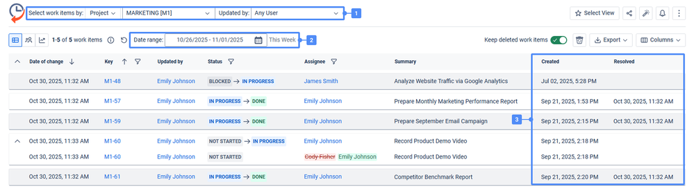

  • Issue History for Jira from SaaSJetallows you to see when each work item was created and resolved.
Using this app, you can filter work items by project, updater, and date range. In the Columns' menu, choose the fields Created and Resolved. You'll get such a report.

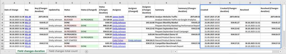

Using the Advanced export option in the app, you can generate the Field changes duration report, which shows how much time was spent between task creation and resolution. For example:

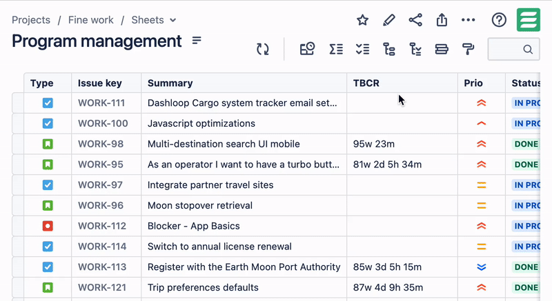

If you're open to solutions from the Atlassian Marketplace, you may want to have a look at the app that my team and I are working on, JXL for Jira.
JXL is a full-fledged spreadsheet/table view for your Jira data that allows viewing, inline-editing, copy-pasting, sorting, and filtering by all your work items' fields, much like you’d do in e.g. Excel, Google Sheets, Smartsheet, or Airtable. It also comes with a long list of so-called smart columns and history columns that aren’t natively available, including e.g. time between created and resolved (i.e, time to resolution).
This is how it looks in action:
As you can see above, you can easily sort and filter by your smart and history columns; you can also use them across JXL's advanced features, such as support for (configurable) issue hierarchies, issue grouping by any issue field(s), sum-ups, or conditional formatting.
This all doesn't require any SLAs to be set up, and works for issues of any project type.
Of course, you can also export your data to XSLX (Excel, Google Sheets) or CSV in just two clicks.

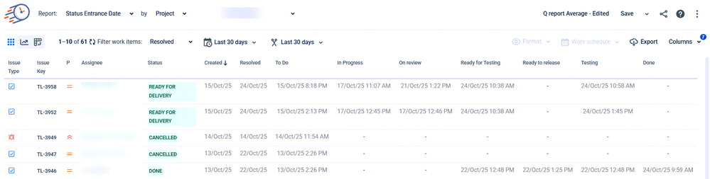

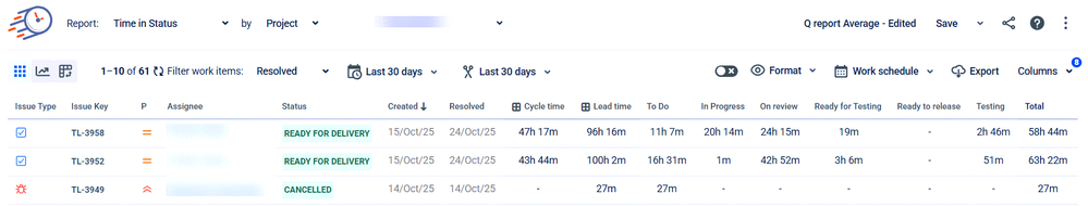

If you don't mind using apps from the marketplace, I can recommend using an app from my team called Time in Status.
Generate a Time in Status report, and add the Created and Resolved columns. You will be able to view the dates and duration for each status. And with the help of the created status groups, you can calculate various time metrics.
The Status Entrance Date report allows you to view the dates and times when tasks transitioned to different statuses.
