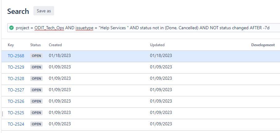

SJ
January 19, 2023
Has anyone seed this before?
I ran this jql on 1/19/2023  and there are issues included where the created date should exclude the issue from the results as we know the status cannot change before the created date.
Trudy Claspill
January 19, 2023
Hello @SJ
Your filter is asking for issues that have not had a status change in the past 7 days and has no criteria related to Created Date. Which issues do you think should be excluded and why?
