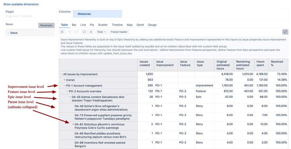

As @Fabian Lim mentioned, you can do this also with Jira apps.
eazyBI is a Jira app for reporting and charts, and you can analyze issue hierarchies that are based on issue links here. For that, you need to define how issues are linked and how to build the custom hierarchy, and then import this new custom hierarchy for further analysis.
There is an example report you can check out: Issue custom hierarchy - Improvements
In this example, there is an Issue hierarchy with two levels upon epics - Improvement and Feature. Quantitative values (Original estimated hours, Hours spent, Issues created, etc) for higher-level issues show totals from their children, while the issue attributes or properties (like Issue type) are displayed for each issue. You can expand or collapse rows to show the level you need.
Do not hesitate to contact support@eazybi.com for any further questions or assistance!
