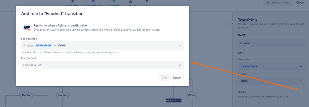

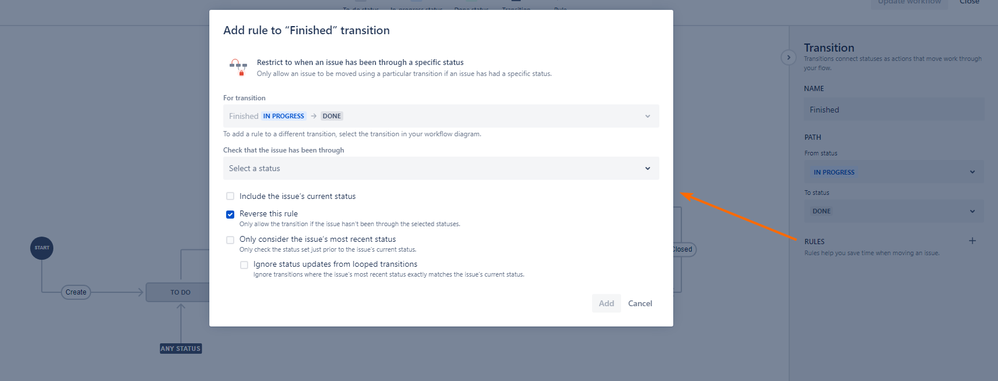

Have you checked the rules that you can add in the workflow section of the settings?
My ideas are:
  1. Add a rule to restrict when a field is a specific value
  2. Add a rule that if a ticket has not been through a specific status it will be restricted.
    • This would need to be followed up by an automation that moves the ticket to the designed status for logged time validation with a trigger on logging time
  3. Create an automation that would revert the status to the previous one if no time was logged.
Let me know if you would like to investigate in any of these options.
Best regards,
Patrik
