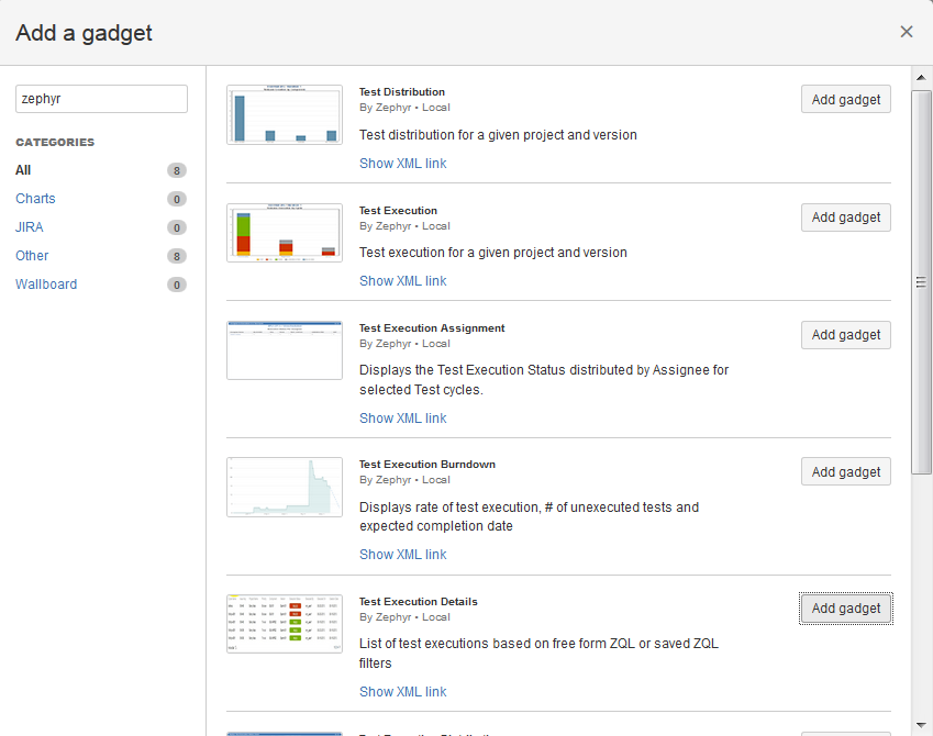

By looking to gadgets, I found some created by Zephyr to use Zephyr data :
I think you can use these to generate the report you want.

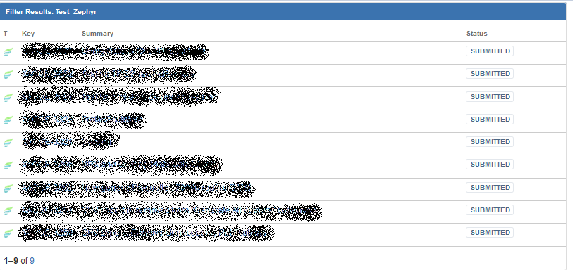

Hi @Petter Gonçalves , the tool you suggest gives the status of the issue, except that a Zephyr issue always has a Submitted issue, this gadget does not give the result of executed tests, the failed test cases and so on, unless I'm mistaken.
I tried and I got this result :
No result is exploitable, unfortunately. (Even if I didn't know this gadget and it is powerful for other use cases ! Thanks )
