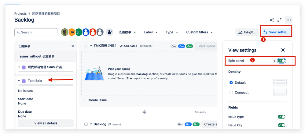

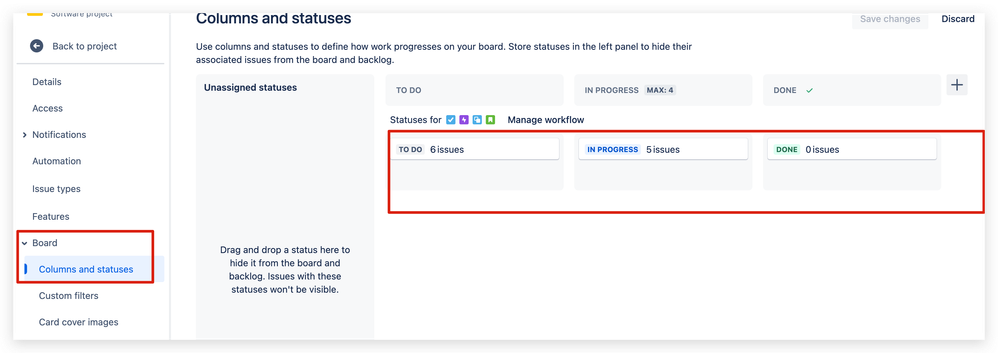

I just created an Epic from the top menu of Create and can see it in the Backlog through this way:
According to what you described above, it seems the initial status of Epics is not configured int he Board -> Columns and statuses (in the left Unassigned statuses?). Please check:
Hope it helps,
YY Bro

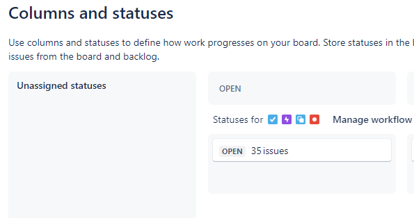

Gordon Robertson October 25, 2024
It shows there are 35 issues. 34 are Epics and do not appear on the Board or Backlog

see my first sreenshot
I saw your first screenshot. All it shows is when you do something it works. When I do it, it doesn't.
If I open the epic panel and create an epic there, it disappears immediately. I can then find it in the List section, but nowhere else. That was why I raised this issue in the first place. Doing what I expect to work, doesn't. So showing me how it should work won't help me, since there seems to be something broken in the backend
