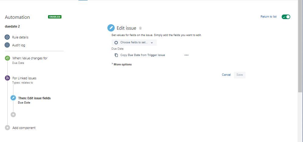

I'm trying to setup an automation rule that when an issue is updated, the due date of all related linked issues will be updated with the due date of the issue. I've setup the following rule:

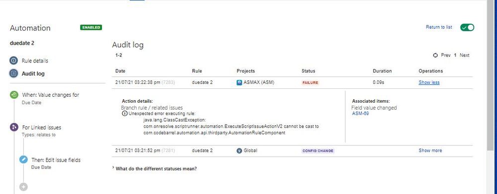

However when I update an issue, its related linked issues' due date doesn't get changed. I had a look at the audit logs of the automation and I see the following:
The error message is:
Unexpected error executing rule:java.lang.ClassCastException: com.onresolve.scriptrunner.automation.ExecuteScriptIssueActionV2 cannot be cast to com.codebarrel.automation.api.thirdparty.AutomationRuleComponent

Bill Sheboy
July 21, 2021
Hi @Jason Yeung
Do you have both the Lite and Pro versions of automation for Jira installed?  If so, it could be this issue: https://jira.atlassian.com/browse/JIRAAUTOSERVER-45
The work-around is to disable one or the other, and the fix is to uninstall one of them...or wait for this defect to be resolved.

Jason Yeung
July 21, 2021
@Bill Sheboy ,
thanks for the info. I have uninstalled the Lite version and it did the trick.
