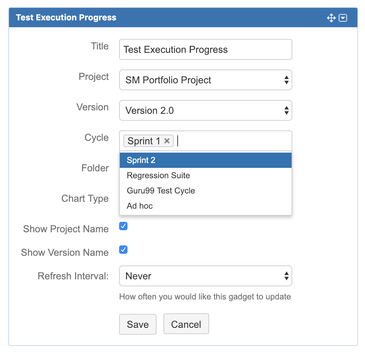

Hi - Tried that, not doing what I need. I have the filter saved - cycleName = "New functionality tests in release 32.0.0" AND project = "Leap Quality Assurance"
The Test Execution progress report will only pick up the entire project - I need a way of getting a report using that filter. That possible?

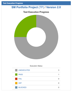

It is possible using that gadget. You can filter the report to a particular cycle by selecting the project, version, and cycle name when you are configuring the gadget (see the images below).
