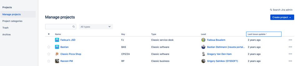

That said, in Cloud you can go to Jira Settings-> Projects and check  the last time that an issue was updated for every project. This could give you an idea of what projects may be inactive (if the haven't been updated in a number of months, e.g.):
Regarding archived projects, this article contains details about how to manage archived projects in the Cloud: https://confluence.atlassian.com/adminjiracloud/archive-a-project-1013843066.html
From the article above, "Issues in archived projects won't appear in basic or advanced search results. You can access these issues through direct links, but you can't edit them"
