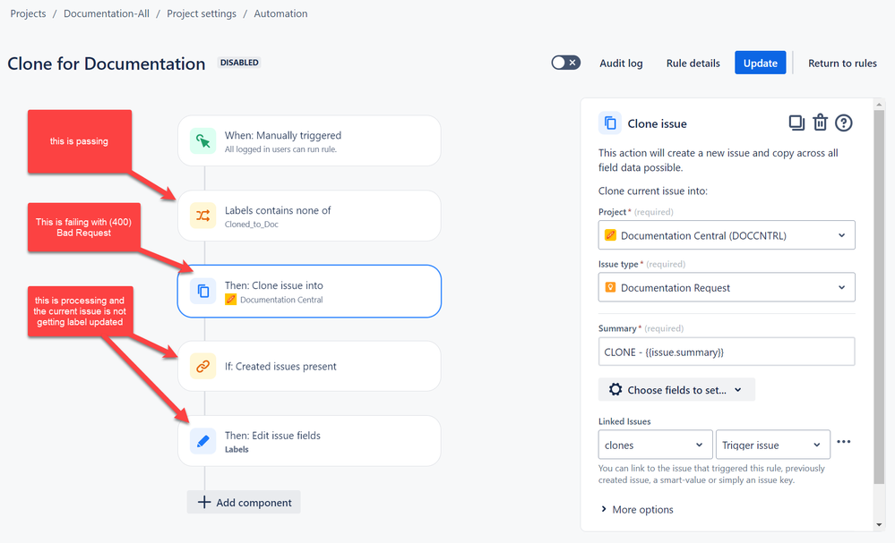

I am trying to use an automation rule that is pretty basic and using manual trigger.  The first step is an if condition that if a specific label does not exist to then clone into a different project.  I am passing this If condition, but then when trying to clone the issue to a different project I am getting (400) bad request message.  When cloning the issue, I have set to clone to a different issue type than the trigger issue type and into a different project.  I am only setting one field while cloning, and that is to create a linked issue to the trigger issue.  The project I am trying to clone into only has 3 statuses - ToDo, InProgress, and Done - the project I am cloning from has these same statuses, but also has about 10 other statuses.
I have a group of test projects where I have enabled this rule, and it is working fine.  I am baffled as to why this same rule is failing in my other project.  Any ideas?

Thank you Andy - support team pointed out that the user that the original ticket was assigned to did not exist in the project I was trying to clone the case into.  I updated the rule to set the Assignee to unassigned when cloning into the new project, and that solved the issue.

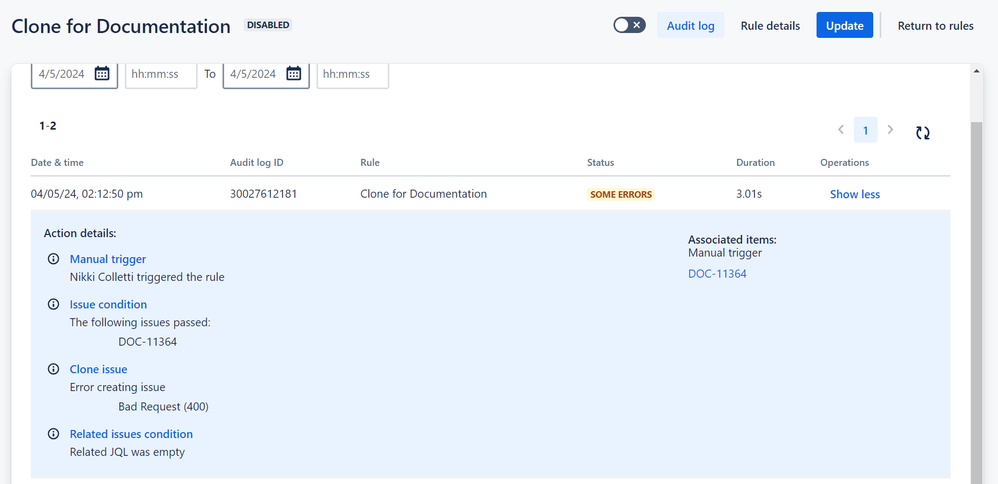

Here is the rule I am trying to use followed by the error it is returning - this exact rule is working in my test projects
Action details:
Manual trigger
Nikki Colletti triggered the rule
Issue condition
The following issues passed:
DOC-11364
Clone issue
Error creating issue
Bad Request (400)
Edit issue
Issues edited successfully
DOC-11364
Associated items:
Manual trigger
DOC-11364

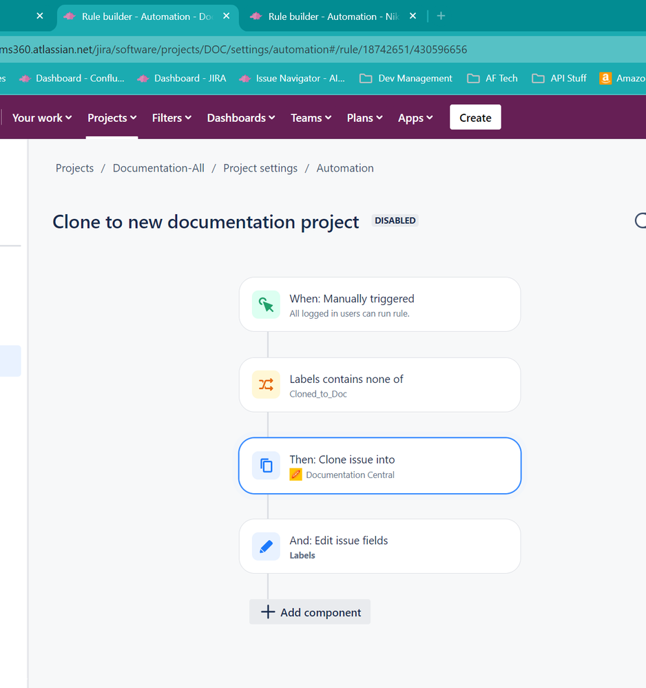

I created the rule from scratch.  I just deleted and created brand new from scratch.  We are using team managed projects (kanban).  I have the exact same scenario setup in a group of test projects that I use to test new automation rules, and it is working in the test project.  Initially when I set up the rule in this project it was done as an automation trigger based on transition of a status.  After turning on it was tested and it ran, there were two other successful runs, and then it started to fail without any changes being made.  I tried making a few changes and it still would not create the clone.  I then deleted the original rule and created one based on a manual trigger. This was first created in my test environment and it worked fine, but when I set up the same rule in our main project it failed to create the clone

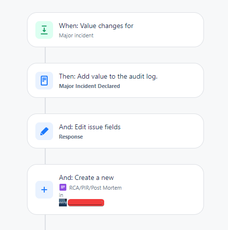

This may be linked to an issue I am seeing, also getting a 400 bad request on create. the automation is straight forward, when Major Incident is toggled create an issue and link it.

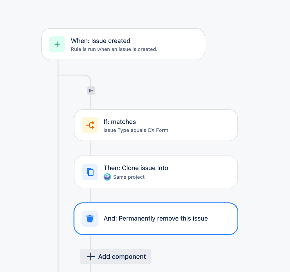

I am also running into this issue. Fairly simple cloning rule that has been fine for weeks is now failing with (400) Bad Request

I found the issue for myself, someone had set one of the custom fields which were getting set in the 'create issue' as 'required'
So I had to declare this specifically within the 'create issue' and COPY from source.
That stopped the 400 error I was seeing
