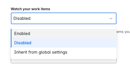

Individual users can disable and enable this setting also by clicking on the gear icon and selecting General Settings and adjusting this option:
