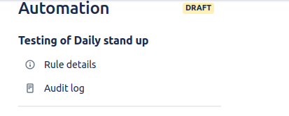

In this picture, I'm on project A and trying a JQL on project "CLIENTE"
If I open automation for project "CLIENTE" and use same JQL, all issues will pop up. but if I change JQL to Project A, none will show up
I also tried on Global rules, all rules and project rules. result is the same.
I meant to say earlier. When I search on advanced issue search, yes I can filter to one single issue. then I copy that JQL parameter and past on Automation Lookup issue JQL and there, it does not show anything because its not for the same project.
